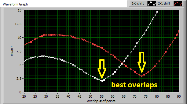

As a quick followup, here's a graph for the "mean r" difference after shifting as a function of overlap. The min is the optimal overlap and the mean of the point differences is the optimal xy shift.
If the data points are not roughly equally spaced along the each of the three arcs, you could probably fit each to a low order polynomial (or other suitable function), then generate a set of closely spaced points for each segment where the points are sorted and have equal distance steps along each arc.
