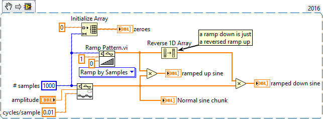

A few breadcrumbs, I won't be able to walk you through all the details start to finish:
1. I assume you'll generate this signal with a Continuous Sampling AO task.   Look at the shipping example for "non-regeneration" which keeps writing new data to a task in a loop.  You'll be doing something similar.
2. To make life easier, I'd write the same # of samples every time *and* I'd make that size hold an integer # of sine wave cycles.  Then you can probably just calculate the data once and keep writing another copy of it to the task over and over.
3. In addition to this re-usable chunk of data, I'd make 3 other special chunks of the same size.  One will ramp you up to full amplitude, one will ramp you back down to 0, one will be a constant bunch of 0's because you won't be able to perfectly time your software stoppage with the exact end of the hardware ramp-down.
   You'll write the ramp-up chunk first, keep re-writing the normal chunk in a loop, then write the ramp-down, and finally write the chunk of 0's enough times to be sure you gave the shaker a soft landing.
   The snippet below shows how to take a normal sine wave chunk and make the other special chunks.
-Kevin P
Message 7 of 9
(3,121 Views)
You can also just write your "ramp down" value once, then wait until you get a buffer underflow error, then stop your task. IIRC there are two possible errors that will be generated in this case but I don't have the specific error numbers in front of me.
Message 8 of 9
(3,095 Views)
That's a good idea and will be a simpler way to be sure you end at 0.  You'll probably need to explicitly disallow regeneration (prior to starting the task) with a DAQmx Write property node as seen in the shipping example.
Many many years ago non-regenerating output tasks used to be pretty tricky to deal with, but DAQmx has gotten much better and handles things rather well these days.  You can see in the example that all you've got to do is call DAQmx Write in a loop and the driver manages all the details about timing and buffer locations.
-Kevin P
