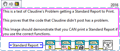

How curious!  Here's a LabVIEW 2016 Snippet of the VI I just ran:
As you can see, it is virtually identical to the one you posted.  There are, I believe, only a few differences:
  • Your code is in LabVIEW 2015, mine is in LabVIEW 2016.  I do not believe this accounts for the difference in behavior.
  • Your code uses Controls, where I use Constants, for Report Type and Text.  Again, this shouldn't be the difference -- indeed, I ran your code with "This is a test" and got printed output saying "This is a test" (running on the LabVIEW 2016 RTE).
  • We are using different printers.  I'm actually "on the road" with my laptop on my lap, not connected to any printer.  The Print Report function has a Printer Input that, if left blank (as both of us have done), defaults to the Default Printer.  I don't have a Default Printer defined, so I defined my Snagit "printer" as the Default Printer, and got the result(s) I expected.
Do you have a Default Printer defined?  If not, you need to specify the Printer in the Print Report function (right-click the Function and read the Help message).  Let us know if this fixes things for you.

Confession -- Since I'm "on the road" without a true printer, I also tried setting my default printer to Adobe PDF.  It also didn't work.  Since I have/use Snagit, and it installs a "Snagit Printer", I then tried setting the Snagit Printer as the Default, and it worked like a charm!
I have no idea why setting Adobe PDF as the "Standard Printer" would fail, but Snagit would work.  Well, I do have an idea -- when you print to Adobe PDF, you don't get a "generic" output.  It want to generate a named PDF file, which involves some sort of "behind-the-scenes" Magic.  For Snagit, it "prints" to an Image that can be saved as a PNG (which is what I attached), or can be sent to a "real" Printer.  I suspect that if my HP Whatever were set as the Default Printer, I'd have a piece of paper in my hand.
So my "best guess" is that you are trying to "print" to a non-standard "Default Printer" (Adobe PDF) that the RGT is not able to handle.
If this isn't resolved by Monday, I'll be back, with my HP available, and I can test my hypothesis ...
