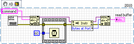

hi
i am facing the same problem as you were facing,When there are two or more messages in the VISA buffer(i am reading 4 messages), the separation of the messages is incorrect.the first byte of the second message is at the end of the first and so the second message in the buffer seemed to be incomplete
how can i fix it i am attaching a screenshot of my schematic kindly have a look at it and suggest me how to seperate the messages read from the visa buffer..
thanks
