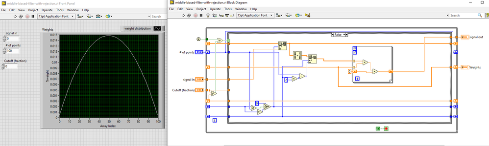

Unfortunately I do not have the hardware to characterize the signal better, but I did have some time today and made a rough simulation of what I remembered seeing and making a custom filter. The general idea is keep an array of signal inputs, sort the array and assume the points in the middle have more weight than the extremes. That worked pretty well, but the large spikes I had seen would drive the filtered signal up until that point was removed from the array so I also added the ability to reject points on the outsides of the range. It was a pretty fun little project and I am happy with the simulation data I ran through it. I will need to see how it actually works with the hardware.
I call it middle biased filter.
(LV 2016)

Hi Steven,
you might think about simplifying your filter, like removing unneeded FOR loops!
See attachment…

Thanks Gerd. I did use some of your simplifications, added a few of my own, added a few checks to re-init if the user changes parameters, added a custom warning message, and added an unexposed variable to change the weight distribution.

Hi Steven,
Well:
  • InRangeAndCoerce with limits 1...+Inf is the same as taking the max of input und 1. There's a MinMax function…
  • The FOR loop inside the TRUE case only should contain "i" and ToDBL. All other operations can be applied to the resulting array outside the loop.
  • When you want to generate an error then you should set the status of the error cluster to TRUE…

Is there any benefit to using min max as opposed to in range and coerce?
The for loop CAN only include the I, but I did some tests and it runs faster as is. It is slightly less obfuscated and runs faster, so that is how I am going to leave it.
I specifically am using the WARNING feature of the error cluster, not an error.
