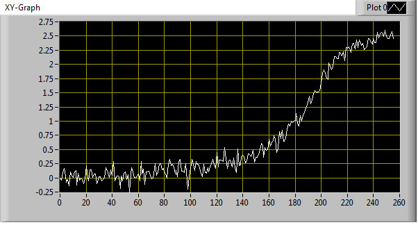

Hi all,
I would like to know how can I smooth this graph?

Hi Danil,
Thanks for your reply.
This graph is plotted at real time point by point.
How do I know that my data are evenly spaced?
Sorry I am not allowed to enclose the VI. Here is a picture.
Is it possible to smoth the graph at real time when it is plotting or must I wait for the graph to complete plotting? Thanks!!!

You don't show where the blue wire is coming from, but chances are that it is connected the the iteration terminal. This means that the samples are equally spaced in x. You don't even need an xy graph in this case, a simple chart would suffice.
Since your data arrives one point at a time, you need a ptbypt smoothing version. Look it the "point by point" filters palette.

Hi Altenbach,
The blue line can be said to be coming from from the iteration. It is the iteration multiply by the value in control.The Vi is set to stop at 255.
e.g control value = 1, I will have 256 pts.

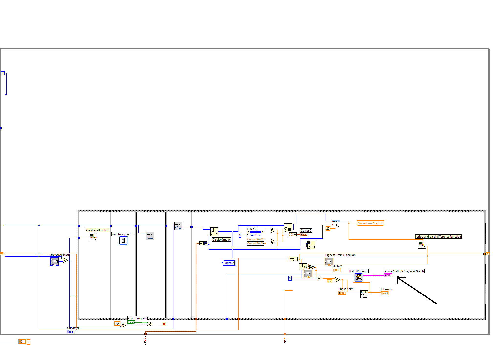

Hi Johnsold,
