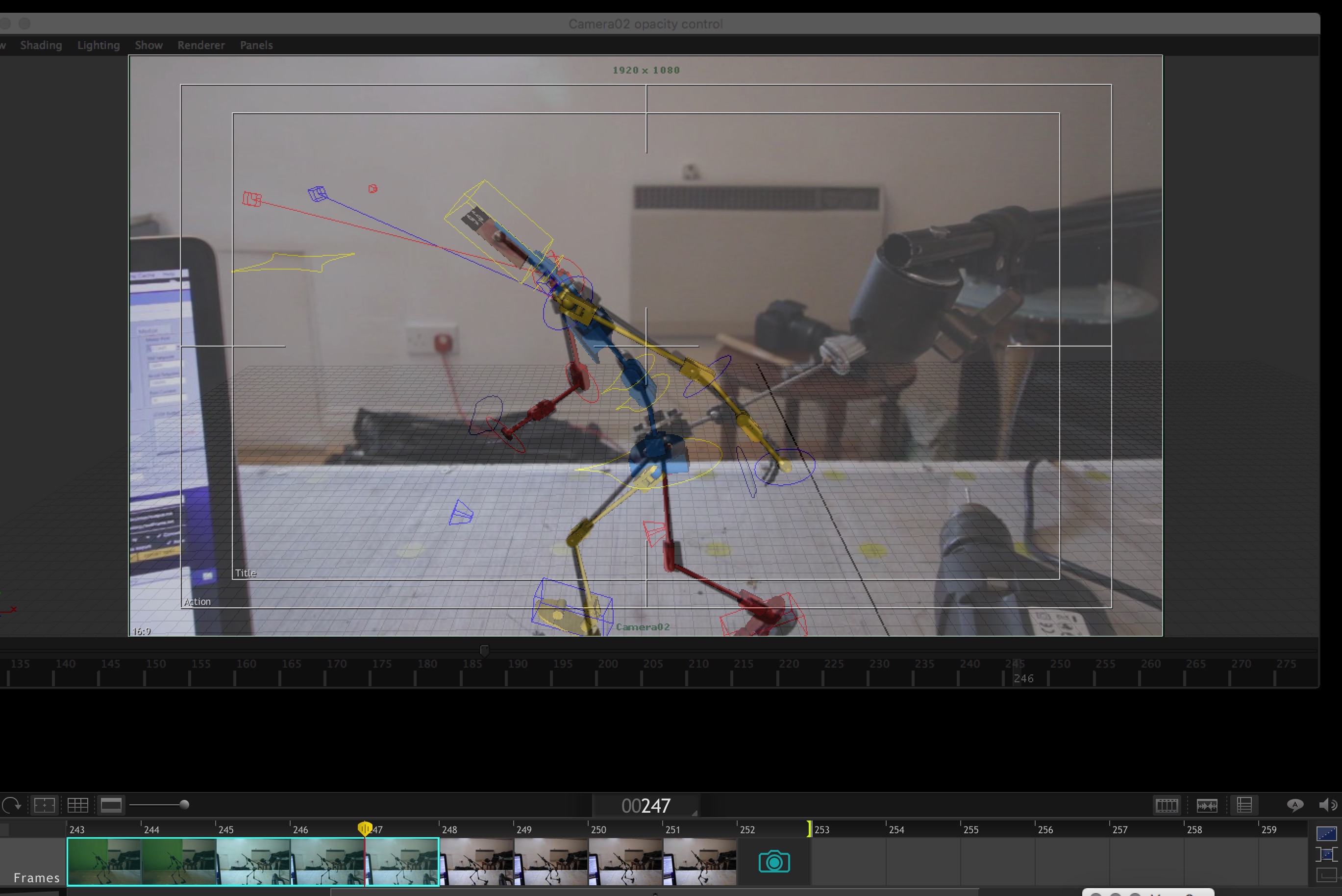

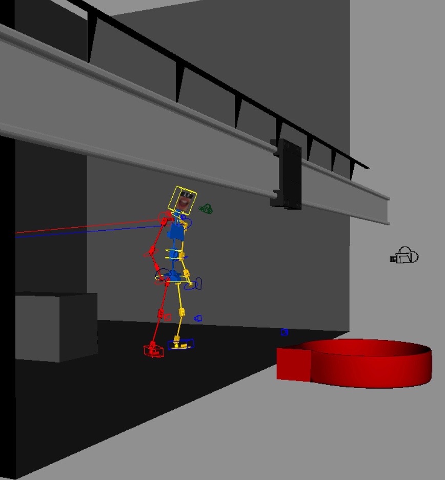

Hello Kevin.
This has taken a long time. It looks like a simple slider in real life, but it works and matches Maya, dragon frame.
It involves two other IV's, A ton of Maya code and Arduino Code.
It is stop motion, Timelapse and hopefully real time.
I took the rig to Phill Tippets studio and introduced it to LIAKA. I am now adding pan and tilt for two studios in the Czech Republic that want to use it. I just want to make it work as my original idea way back.
1) I film a real set with a camera on the slider.
2) I capture this in in Syntheyes - Turns it into 3D tracking
3) I then export that to Maya - Now I take over the Syntheyes camera and get Maya to animate it. Finally, the real camera matches the Maya camera and the real set matches the Maya set.
4) I animate a character in Maya and mix the live render with the real camera on set (Augmented Reality)
5) I can the trace the animation with stop-motion.
6) Next, I want to film real time and mix that with the stop motion.
Hope this answers some of your questions.
So far the stop motion and Timelapse are perfect.
Thank you for your mail. I hope this helps.
If you can help I will be delighted.
Mike
