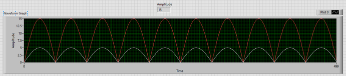

I tried an algorithm that will toggle a Boolean to change the values, it worked fine for me.
but the amplitudes are showing in two separate signals.
to explain more, I attached the vi that I created, the only thing that I still need is to do is to make the white curve appear once, then the red curve, and the would alternate during the loop.

Here's a simplified version:
Note that the tunnel on the right edge of the while loop is set to "Concatenating" mode (right click to change this setting), and further that the Flat Sequence Structure does nothing (so I probably should have removed it).

I changed my code to correspond to yours, and this is what i got.
what other changes have you made?
Message 9 of 11
(6,673 Views)
Accepted by topic author MAG98
Right click on the tunnel with orange wire on right side of the While loop and change the mode.
I used Concatenating, you used Last Value.
