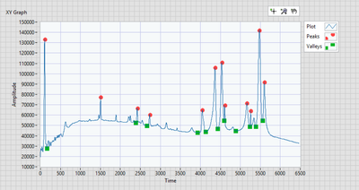

Peak detection is a complex topic, but there's a simple solution if you simply need to automate finding peaks and valleys. If you simply define a peak as lying between valleys, you can use peakdet.vi, a port of a popular MATLAB script.
The LabVIEW code is available on my github, and attached here with a demo in LV2012.
Feedback is welcome.

Thanks Russell. I remember using this script with Matlab in the past.
One question - The algorithm depends on a delta between the valleys and peaks, why do you define this as "without threshold"? Isn't that delta the threshold?

Its a "relative" threshold (applied to the first derivative of the signal, not the signal itself) and the peak detection depends on two factors: (1) The relative difference between two adjacent points AND next point lower than second. I have the nagging feeling that this could be implemented with 10% of the current code. 😄
Quote from the text code comment:
% A point is considered a maximum peak if it has the maximal
% value, and was preceded (to the left) by a value lower by
% DELTA
Personally, this feels more like a "spike detector", because e.g. a beautifully smooth and wide gaussian peak would not be detected as such.

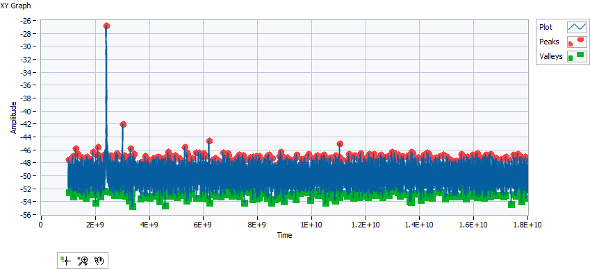

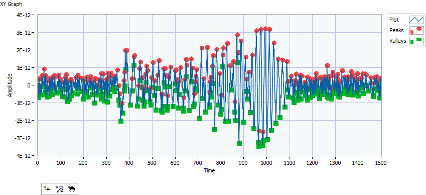

a) A useless semantic distinction, and b) incorrect. On the latter point, there is no practical difference between a  "broad" and some other gaussian, and peakdet is by design agnostic to noise ("smoothness"). But importantly, LabVIEW isn't a "feels" language. A simple test shows a Gaussian of any width is detected as long as it exceeds the delta value (as shown in the demo provided, which contains a trace with multiple gaussians)..
As demonstration, here are your examples with 5% Gaussian noise added: (and no, even tuning delta by an order of magnitude in either direction does not change the outcome).
Since delta depends on a first derivative and not on peak amplitude it is difficult to guess a good value without trying. A broad gaussian has nearly zero slope around the peak and any noise will overshadow the delta.

@altenbach wrote: some bad examples.
Showed provided examples not working after adding noise (to already noisy signals), used the provided default deltas, and claimed that changing the deltas did not affect the result.
I'd hoped it would be obvious that providing deltas larger than the noise and smaller than the peaks would produce the desired results:
