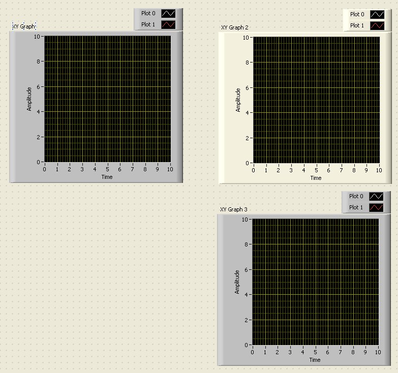

I can't seem to figure out how to revert to the original color of the Silver Graph legend after I have painted it some different color (Graph 2 below, painted "System"):
I used the color picker for the main body and legend of the original graph (they are identical, apparently), but when I use this color choice, not matter where I apply it (corner, center, etc), I get the weird result shown in Graph 3). What gives?

I agree this is a bug and will file it as such, but I also want to explain what's going on.
The Silver controls have the background of the plot text set to transparent so that you can see the gradient of the Silver decoration behind it.
When you color the legend, it is changing the foreground and background colors on the plot text as well as on the frame. The way the Silver decoration works, these two colors are the endpoints of the gradient, so you're getting the darker color as the background of the plot.
I will probably fix this by having the coloring tool leave the background as transparent.
To fix a graph with this problem, you would need to use the Control Editor. By switching to "Customize" mode, you can select the plot text and choose Edit>>Customize Control to open it in another Control Editor where you can color it.
