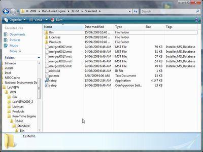

No need for a spec file?
Where do I locate the RTE with this msiexec.exe?  This is what I have..
 Thanks.
Message 9 of 20
(4,456 Views)
Do I need to place all these files into the Project?
Message 10 of 20
