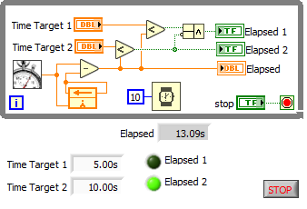

Hello. I'm new to LabVIEW. I'm making a program where I have 2 boolean signals from Elapsed times and first Elapsed time is connected to boolean indicator. I need to block this signal (set signal to false) if the second Elapsed time is sending Time has elapsed signal. How can I perform this?

First, new users should ALWAYS show the Help Window.  Press Ctrl+H.
Then look at the boolean palette and check out Implies.IMPLIES.
Sure you could use a Select primitive wiring Timer 2 to Select, a F constant wire to True and Timer 1 wired to False.  But that just computes (!X) OR Y where :X is Timer 2 and Y is Timer 1

As a first step, attach a simplified version of your code, because your description is not clear at all.
See if this can give you some ideas....
Of course it would be easier to use an array of time targets and an array of LEDs and simply light the highest that is TRUE, for example. Scalablility!!
