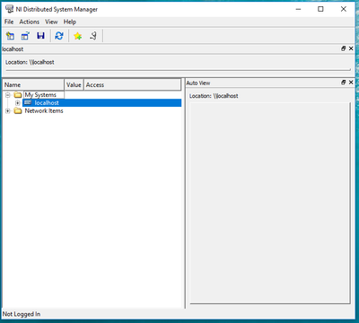

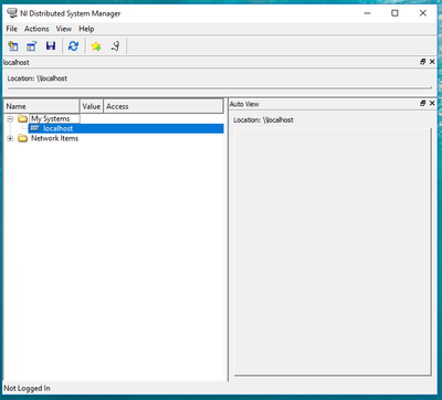

Hi all,
I cannot find my shared variables in distributed system manager even after deploying them. The shared variable engine error also appears if I try to access them inside VI.  I have already tried un deploying and deploying, restarting LabVIEW and my machine. Any helps would be much appreciated. Please find below two screenshots for your reference.
Expand option is availableExpand option is availableClicking on the expand option would give me nothingClicking on the expand option would give me nothing

Hello Kevinks,
What happens when you run your application that is using the shared variables and then refresh the DSM?
The Shared Variable Engine can be finicky from my experience. It also looks like you are creating/using shared variables on your local computer rather than an RT target. I think that might affect how they are displayed in the DSM. As a test, you can create a simple VI that writes a random number or value to one of your shared variables every 500ms. While this VI is running, check the DSM by either closing and restarting it or pressing "refresh" within the DSM.

In DSM, if you go to Actions -> Stop Local Shared Variable Engine, wait ~5 seconds, then start the variable engine again, and then redeploy the variables do they show up? You might have to hit F5 in DSM to refresh the listing after deployment.
Can you create variables from within DSM? Do this by right-clicking localhost -> Add Process, give it a name, then right-click the new process and Add Variable.

@jhoehner wrote:
Hello Kevinks,
The application crashes with Shared variables not found error
(4,073 Views)
Nope.. This had no effect
This worked, though a refresh would return DSM back to the previous state with nothing inside the localhost drop down. I am doubting that the DSM is corrupt. Will reinstall labview and let you guys know
