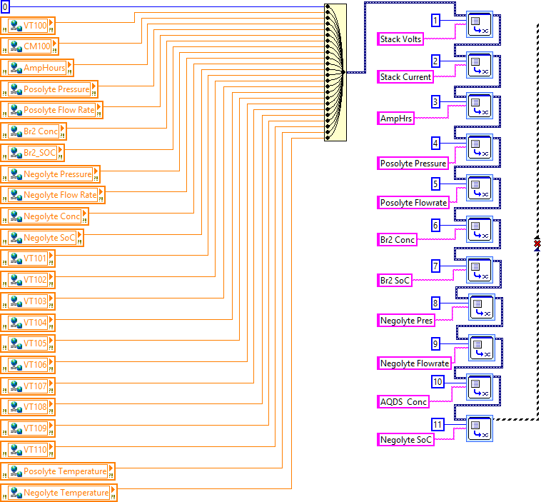

Hi I have a project that tests a flow battery, takes data and puts it in a file.  The problem I'm seeing is that the data isn't all getting from one vi to the data file in a second vi using shared variables and global variables, (some is but others are not!) .  In the analog inputs.vi I get data process it and connect it to a global variable.  In the multi-point UI.vi (the main display user interface vi) I connect it to a numeric display and to the section where I add it to a data file.  But here is where I get an error.  the data in the analog input vi is good but the data passed by the global variable is not I can show the flowing pix and I have attached a zip of my project.  I am using LV 2014 and a NI sbRIO board.
In the first picture it shows how I get the data from a channel on the sbRIO board
The second picture shown a global variable as the input to a data file - there are other things going on too

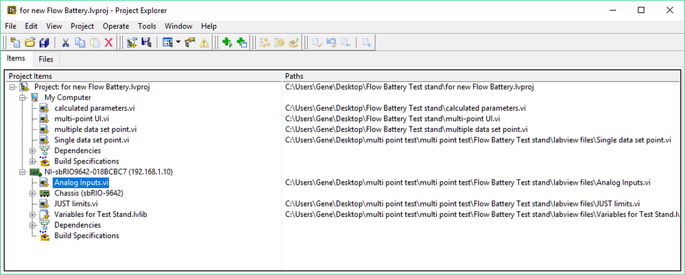

The third picture is a snapshot of my project.
I hope I have provided enough input, my question is why would the data be OK in one vi but not in another?  When I probe a data line of a global variable in one vi the data is good, but a probe after the global variable in a different vi does not read the same data?
I know I doing something wrong but what is it???

@justgene wrote:
I would like to see an example of sharing variable data between various VIs in a single project.  I do not understand why placing data in a variable inside one vi wouldn't just be available to another.
Because you are talking about communicating across TARGETS.  Each target is its own computer and application.  It is not just a simple write variable at that point.  If going the Network Published Shared Variables, you have to make sure one of the targets is the variable server and has deployed them in order for other targets to use it.  But even then, I have found NPSVs to just be a major pain since they are SLOW and I have seen nothing but very strange race conditions from them.  I have had to do so many work-arounds to get them to work that it was actually A LOT simpler to do my own TCP/IP messaging (using STM).
