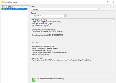

I am trying to test my hardware setup, comprised of a 7972R FPGA module with a 5751B Adaptor module by setting a digital output pin to high and reading it with a multimeter.
I have attempted to do this by giving a FPGA digital output node (D0 0) a True constant FPGA item, and enclosing this inside of a while loop which is constantly running.
I have compiled this onto my FPGA, which has the adaptor module's digital IO connector plugged into a breakout box. However, I can only read 0V off of the associated pin. Is there something wrong with my setup, file tree, or code?

The nodes for the 7972R are explicity either input or output. I know that the one I'm using here is an output node, so that isn't the issue. I'm thinking about trying to simulate it somehow to see whether the logic is correct
