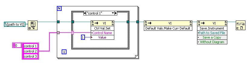

So I know this has been discussed before but I have a unique situation.  I will be downloading code to Arduinos using the Labview Compiler for Arduino toolkit.  I would like to programmatically set some default control values on each Arduino using a Labview GUI.  The Arduino toolkit I am using has a compile VI that takes a VI, compiles it, and then downloads it to the Arduino.  How can I change the default value for the VI's controls before it's compiled and downloaded?

Thanks but I want to do this programmatically without having to open the VI.  I will have a GUI that will download the program to multiple Arduinos and the control values will be different for each one.

Have you tried using property nodes to set the values and then method nodes to "make current default" and save the VI?

That worked!!  You rule.  I had to add an error handler because I kept getting an error message from the Set Values as Default block saying that the target VI was not in edit mode, even though it was.  Anyway it set the control default values successfully so I just ignore the error.  Thanks for the help!

Not sure why you would be getting that error, but I'm glad it's working for you. And since we're on the subject, a simpler alternative way is to use the Ctrl Val.Set method:
