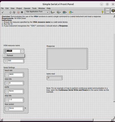

I need to use LabVIEW under Linux, I use LabVIEW 2025 and the OS is Ubuntu 24.04.2 LTS.
I'll need to communicate via a serial port with another module. i installed NI-VISA but when I try to run a LabVIEW example, the enum of the VISA resource name is empty, even if the COM port is plugged and available via the Linux Terminal.
I'm (clearly) not a Linux expert, so every help or brainstorm'll be helpful...
What did I miss ? Which package didn't I install ?

Found it !
It took me a day but the issue came from ni-serial and/or ni-visa was not correctly installed.
To solve it:
1. Uninstall LabVIEW from Ubuntu
2. Reinstall it
3. Reboot
4. After the installation of LabVIEW, install .deb from NILinux2025Q2DeviceDrivers (the ni-ubuntu2404-drivers-2025Q2.deb for me, not the stream
5. Reboot
6. Follow this link to install all the drivers you need (ni-visa, ni-serial, ni-daqmx, etc, a good list is here). You may need "dkms" package before all the installations.
7. After each package installation, reboot (that's what I did and I'm not disappointed)
