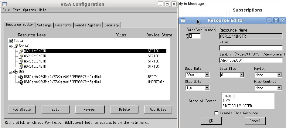

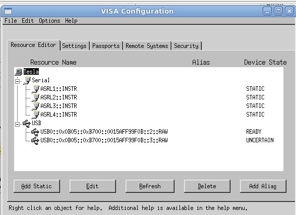

 I have installed Labview 2010 on Fedora 13 along with NI VISA. Although, I am not able to access the any of my USB ports via LabVIEW. I have read the article on Troubleshooting Serial Communication in Linux. I have tried running LabVIEW and visaconf (from the command line) as a root user in case I did not have sufficient privileges for the directories vxipnp and natinst, I do (lock symbol was not on either of the directories). My end goal is to communicate with Arduinio Duemilanove Atmega328 board. This question seems more and more suitable for a LINUX forum as to LabVIEW. In any event, help would be greatly appreciated.visaconf.jpg

I am not using a special serial to USB cable, both nodes have the USB symbol on it. I am able to communicate with Arduino via LabVIEW 2010 on a Windows 7 machine. My problem, I fear, is native to LabVIEW on a Linux machine (Fedora 13). It is on Linux OS that I am unable to access any of the common serial ports. However, Arduino 0022 software comes with a "serial monitor" and using that I may communicate with the board.
 In windows I am able to write a simple VISA read/write program with resource name already available to me, in Linux however I receive no resource names.
To summarize:
LabVIEW, on Linux, can't access the port to which Arduino board is attached to(I am quite sure it is /dev/ttyUSB0).
LabVIEW, on Windows 7, can access the port to which Arduino board is attached to (COM6).
Arduino(Alpha 0022) software, on Linux (so far, only as a sudo user), can talk to the board using "Tools>>Serial Monitor"

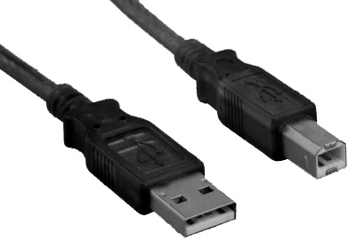

I am attaching an image of the cable that I am using, if that is of any assistance. Thank you so much for the help.

Hi fchandur,
Can you connect to the port using a tool like minicom, putty or C-Kermit? That will be the first step in troubleshooting what is going on. Also Fedora 13 is not a supported Linux Platform by NI, so it is possible that it may not work. For reference the supported Linux platorms are:

Accepted by topic author fchandur
Finally, I have been successful in fixing my problem. Though it is no better than duct taping it. Go to Visa Configuration GUI, double click on ASRL1::INSTR. This will open up the Resource Editor window, under Binding change the path from /dev/ttyS0 to /dev/ttyUSB0; save the changes. Now, that path is fixed: you want to start LabVIEW 2010 under sudo. Once the LabVIEW is all fired up and a blank VI is ready to be written on, its time to test if the changing of binding path has done the trick. Put in a VISA configure serial port sub VI in the block digram and link the constant "ASRL1::INSTR" as the resource name, and check if any errors have risen.
I still do not know why I can not access serial ports as a normal users I made myself part of all groups under System>>Administration>>Users and Groups. Anyways that a question need be explored in Fedora forum. Just hoping against hope that it is a simple fix.
