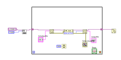

I am a complete beginner with Labview. My task is to control a device which is on COM-Port 4
It has the following properties:
I know how the device normally responds to Input, in MATLAB i simply send the string "!0XFFFFFFFFFFFFFFFF" and when i read the output i get the response "Data shifted, output latched, flags are cleared"
However, when i implement this in Labview i get the Error (from my Communication Device)
Note that these are two separate lines, but in Labviews i need to read twice to display this entire message (for some reason)
and this error (from the error channel): 0x3FFF0006 (https://knowledge.ni.com/KnowledgeArticleDetails?id=kA00Z000000P8BmSAK&l=de-DE)
As i understand it the amount of transmitted data is equal to the requested amount of data, but there is more data, as a result i get a FIFO overflow, which also is a error message i get: "ERROR in UART-RX-Callback: FIFO overflow" and then " FIFO is now empty, flags are cleared"
Here is a screenshot of my VI (the file is also included)
Does anyone have an idea why i get this I/O error?

Probably because you are using "Bytes At Port".
I suggest you watch this video VIWeek 2020/Proper way to communicate over serial

I'm new myself but I think I'm working on a similar problem.If anyone on here corrects me, listen to them (I know I will).
It might be that the message your trying to communicate is supposed to be in binary and as a result the device isn't getting the message you think it is and therefore isn't sending the response you normally get in MATLAB.
