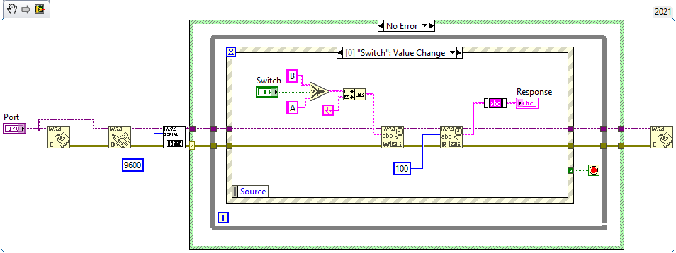

Hello everybody,
I am currently working on a project with my Arduino Mega and want to build a GUI for it using LabVIEW.
In this project I want to control an electromagnet by a boolean button. Depending if the button is in the "true" or "false" position, a 'string' should get send to the arduino switching the magnet on or turning it off. Since I want to use more components, and with that more buttons to control them, later I need to use a 'string'  instead of an 'char' in order to be able to send more detailed commands to the arduino.
In the attachments I send you the code for the Arduino and my LabView VI. The Arduino code should be correct since using the serial monitor of the Arduino IDE for the input works perfectly fine, but with LabView I'm a total beginner, therefore I can't really tell what I did wrong there.
Appreciate your help!

I'll attach a copy for older versions.
I also did some improvements from suggestions I found on the internet. The VI now will send the 'string' to my arduino, but only if I delete the while-loop. With the while-loop (as shown in the VI I uploaded) it still won't work. But I guess I need the loop if I don't want to manually start the program again everytime I want to switch the magnet on / off?

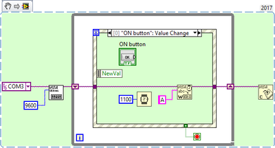

According to the documentation (not really good) and other info I found in the web, readString keep filing characters until a timeout elapses. I read on https://arduino.stackexchange.com that this timeout is 1 second. Your program sends a character every 500 ms, so we can guess that readString never returns. You should use two buttons, one to switch on the magnet the other to switch it on; put a wait of 1000+ ms with each VISA write. Check the modified code. I used buttons that are automatically released after read.
Paolo
