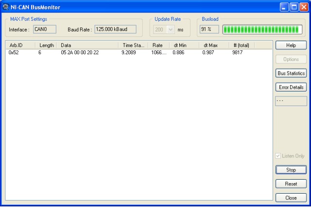

So far I have tried some of the existing examples from NI and I cannot send multiple signals over the same CAN BUS.
I thought it may have something to do with the CAN messages I imported into MAX so I installed NI's example messages of TransmissionFluids & InstrumentPanel.
I have tried to send these messages utilizing the example linked to the previous post but I have not had any success as of yet. Below is a view of my front panel.
When I run the VI the bus only recognizes one message being sent as opposed to the two messages I am trying to send.
I have also attached a copy of my bus Port configurations.  I have tried modifying these configurations from low speed to high speed but I cannot read the second message.
Any help would be greatly appreciated.
Tim
(7,024 Views)

Yes I have tried that VI without success as well
I created different parameters for the message such as ID's 5 & 7 at a different period and when I push the messages onto CAN I am only able to read 1 Message.
I modified the parameters by changing ID 7 to 4 and dropping the period to 40 ms and again I am only able to read one message through MAX (However this time it is message ID 4 not ID 5)
I am at a loss why I cannot read multiple messages through MAX.  Is this an issue with MAX?  How else can I verify that multiple messages are being pushed onto the network?
Tim
(7,009 Views)
Accepted by smoothdurban
I was able to push multiple message by making the following changes.
Setting the Baud rate to 500,000 kb.
Setting both CAN ports (CAN0 for writing and CAN1 for reading) to highspeed.
And finally adding an ECU to the network.  Not really sure why this worked other then the fact that it may have created the medium for the messages to be transmitted.
Thanks everyone for their help 😉
Tim
