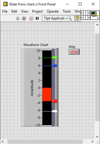

Schieberegler Basis festlegen / Slider set fill-base in the middle
Accepted by trixi0815
or created by a chart..  missed to group the elements 😉
(plots can be filled to zero) .... including some rube code ... (cluster to array ....)
Greetings from Germany

@Henrik_Volkers: Das sieht gut aus, genau so sollte es aussehen 😀.
Vielen Dank allen für die Hilfe
