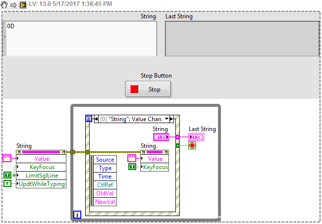

I have a string control where i scan a barecode.After i scan the code i want the value to be read (without pressing any key) and to be empty in order to scan another barecode as soon as possible.

If you right click the string control you will see an option to "Limit to Single Line"
Check it.  The Return the scanner adds at the end of read then just triggers the value change event.

OK, and the return from the scanner is ignored how?, or do you capture the \r in the VC Event case or some other event?
I missed something there (I think)
along these lines:
"Should be" isn't "Is" -Jay
That is a " depends" question.
Depends on what the bar code scanner is providing, and the nature of the barcode that was read. If the bar code scanner terminates with a new line, then that triggers the end of the code and move on.
