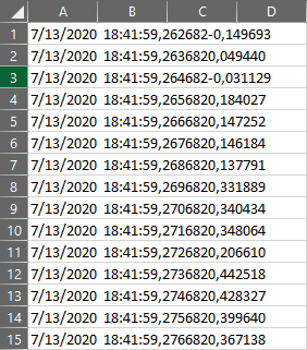

Yes there is block called 'Export to Spreadsheet File' but then I see this:
I can't create time and amplitude labels above the data + the entire date is visible (I want to see only X and Y value of the waveform for example: 0,10;-0,184)

So based on how you are writing your values here, you are in a part of the world where the comma is used as a decimal separator.  So don't use a csv since you, by definitions, will have a duplicate definition of the comma.  So I recommend you use a tab as the separator and save your data as a txt file.  Excel will still interpret those just fine.
And where is the X value coming from?  Is that supposed to be your timestamp?

Here's what I recommend.  Use a FOR loop to format each line of your file.  In this case, I have the date/time stamp, a tab, and then the data point.  Then you can use Build Array to add your header to the front and then Write Text File to write the data.  You could add optimization to the VI by computing the timestamps inside of the FOR loop instead of using the Get Timestamp Array VI.

Okay, I made this like You said. Can You tell me is there any possibility to save .csv file without all date format? I mean without this (and past there for example 0) or it is necessary to read from this file?:
+ How to do the inverse process then? how to make waveform from this saved .csv string file and show it on the same graph?

Without timestamp data, how are you supposed to know the time intervals between data points?  Either you should have a timestamp for every entry or you should describe the time interval in the file somewhere, or no one will know what the graph is supposed to represent.
I go with a timestamp for every row.  It would be a lot easier to graph.
