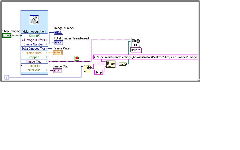

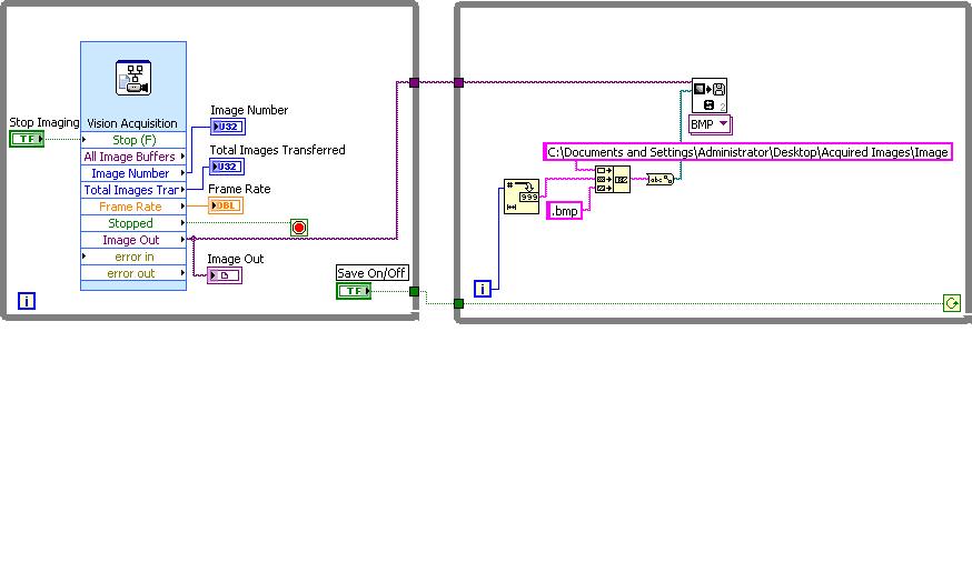

Thanks for the example.  I couldn't find a VI that looks exactly like your 'acquire' vi, but the setup works great with the Vision Acq Express VI that I'm using.  I'm able to acquire and save images simultaneously.  However, I haven't been able to configure a setup that allows me to acquire without saving, then hit a button to begin saving, then hit this button again to stop saving (but continue to acquire the whole time).  Below is my code for simultaneous acquiring and saving, followed by an attempt at adding a 'saving' loop controlled by a button.  I've tried putting a saving loop inside the aquisition loop and tried without having a second loop at all, but haven't had any success.  Any tips for this?
Thanks.

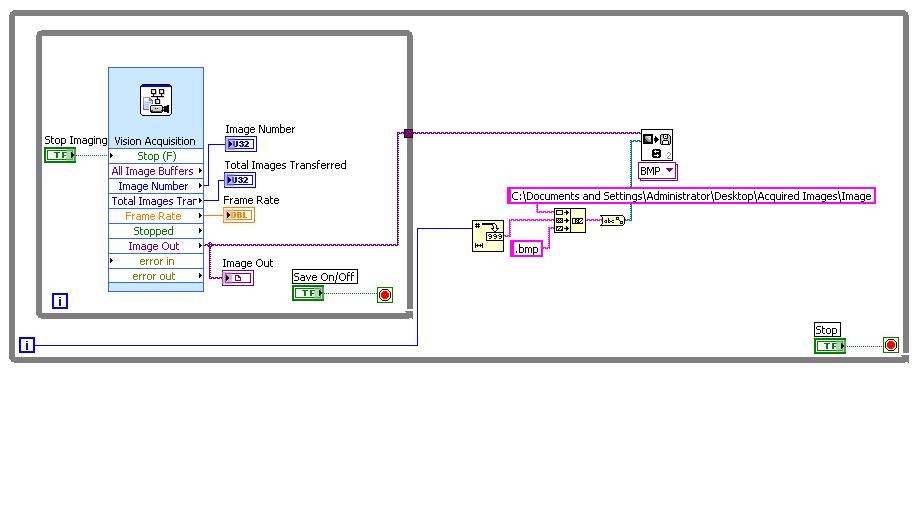

Thanks, it helped, but still haven't gotten it to work the way I'd like.  I used your suggestion as shown below.  It starts acquiring without saving, as it should, but each time I push the save button it saves one image, rather than saving continuously until I tell it to stop.

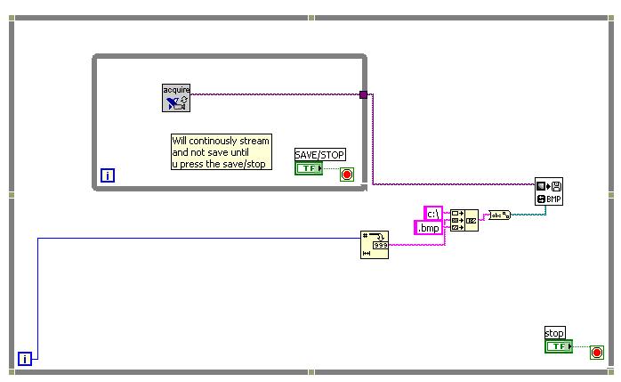

You can use a case structure like this. Remember to keep the boolean in switch when pressed state.
I am not able to attach any image. I am getting an "unexpected error" or something.
The suggestion is use a case structure inside the while loop. So the default which is a false will have one acquire and the true will have one acquire image. In the true constant have your save thing. connect both the images using a local variable.
Will post the scrren shot if i am able to......
