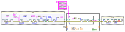

i have finally a connection to my device with SSH protocol , using the LIBSSH2 addon from VIPM.
it works but  my problem is that it takes 500 ms each time i ask for a value. and so 3 seconds to get the answer for the table.
if you have any suggestion for me to try to get this as a normal speed , that would be really great and helpful
it is LIBSSH2  1.2.4 ; Labview 2021-32bits, windows 10 64bits

Have you tried with Putty to see how your unit responds?  That would be my first thing to look at to debug.
Message 2 of 12
(3,053 Views)
I just installed the LIBSSH2 library and did a little digging.  It looks like the read is flat out timing out.  It has no way, as far as I can tell, of stopping the read when the Line Feed is read.
I handle SSH by using an open-source SSH .NET library wrapped around a class.  This library has WriteLine and ReadLine methods that work perfectly for your situation.

Thank you.
I understand that each  read or write will take 500ms whatever we do with libssh2. Correct ?
You solution Iis getting a bit technical for me. would you share an example of how to immlement and use it in labview ?
Thank you

I just spent way more time than I should have stripping out my SSH class to sit on its own.  Hopefully this works for you.
I don't remember which version of the DLL I grabbed.  You will need to have the .NET framework installed to match the DLL.  For instance, if the DLL was built for .NET 4.0, you will need to make sure you have .NET Framework 4.0 installed.

Thank you Very very  much , look very promising.
It seems it is connecting but then i do not get answer to the message.
i was thinking maybe it is because you use the DLL 2023.0.1 and for some reason i can'y load any dll after version 2023.0.0 on my computers.
i tried to replace the 2023.0.1 by the 2023.0.0  in the folder , but then it is not working at all anymore.
anyway i attach the screenshot, in case you have a suggestion.
would be a possibility  that you rebuild it with the 2023.0.0 dll  , any version of .NET seems to load here , see if it helps ?
Emmanuel
