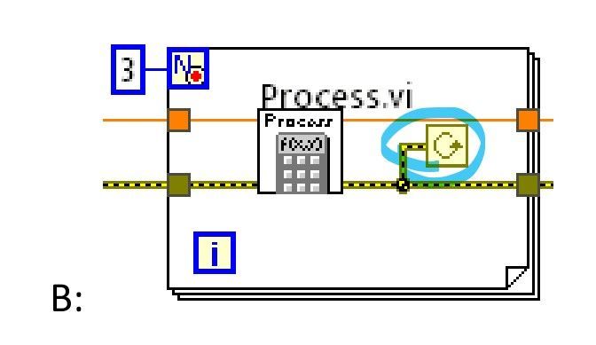

SOLVED: What block is this? Some kind of error retry icon
I'm preparing for the CLAD; and I happened upon a block I haven't seen before, at least not in a for structure. I've painted it in blue. If you can tell me how to create this block, I'd appreciate it. If you could tell me how I could have found it, with zero notions where it comes from, that would also be great.
Edit: Nvm, I figured it out. Just add conditional terminal to the for-loop by right clicking the frame, and then changing the stop icon to Continue while True...

Hi Dr,
it's the conditional stop of a FOR loop, also indicated by the red circle in the "N" terminal.
Read the help for FOR loops…

Well, it is actually a "conditional continue". 😄 (i.e. continue if true). You can click it and change it to "stop if true", same as for a while loop.
