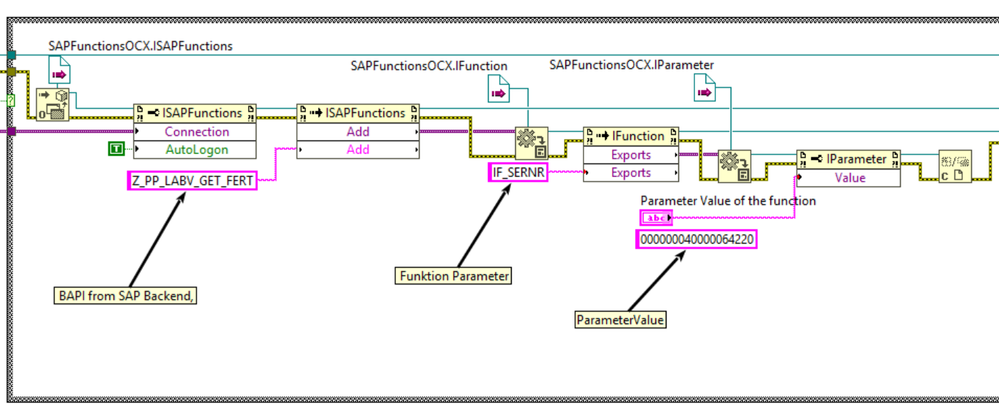

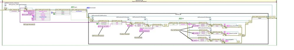

I was able to Export data from SAP server using ActiveX.The BAPI  information (Name,Index,etc) have to be provided by SAP Backend Administrator.ActiveXexport.pngActiveXexport.png

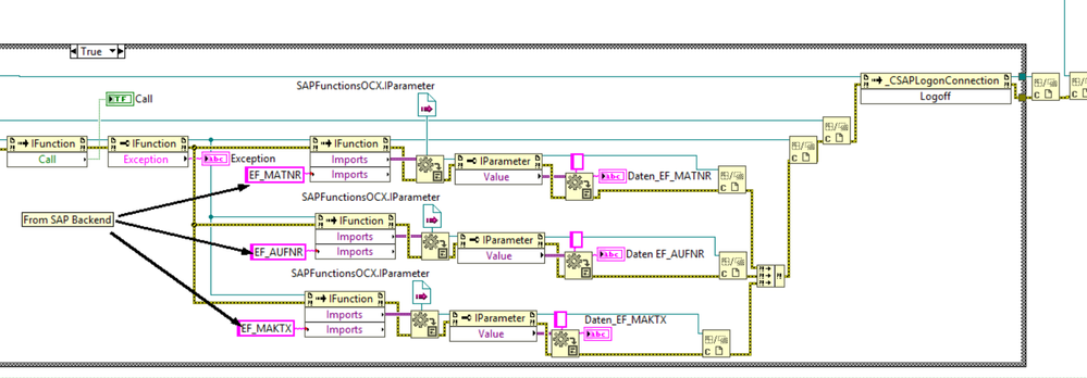

Here is the SAP BAPI ActiveX Diagramm broken down
1.Connect to SAP with SAP Connection Information
2.Send SAP BAPI Command to SAP Server
3.Get SAP BAPI Responds (Import) from SAP Server
SAP Connection InformationSAP Connection InformationSend API InformationSend API InformationGet (Import) BAPI Information from SAPGet (Import) BAPI Information from SAP
if you need more information let me know.
