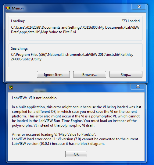

Hi
Sorry for the lack of precision  but i am just not used with labview .
Actually the programm i am working on has been done wiht labview 7 .The programm can be executed normally  on Windows XP  and  i can open the main.vi normally on labview 2010 .
Howeve , as i tried to open  the programm with labview 2010 on windows 7 some of the VIs couldnt be loeded and i did got this error:Capture.PNG
I thought about remooving the block diagramm from the Vis  but i am not sure thats the right solution .

Removing the block diagram is not the solution but is in fact what created your problem in the first place. Someone (maybe the original devoper?) decided that his successor should not get it to easy and removed the block diagram from some VIs. Those VIs can still get loaded and executed in the original LabVIEW version but as soon as your LabVIEW changes, LabVIEW has to access the block diagram to recompile the diagram code into its executable format. Without block diagram this is not possible.
You will have to search the original source code that still contains the block diagram! i'm sure your company uses some form of proper source code control, right??

If you get this error when tring to open a VI, it has no diagram. Possible reasons are twofold:
1) Someone did explicitedly remove them for whatever reasons
2) The VIs got corrupted
Either way the only way to solve this is from backups before the incident happened!

Hii !Smiley Happy
I was wondering if  the missing Vi's are not  ready-made or standard  Vi's from National instrument or  package to fascilitate the work .
  When i try to open any (not only the yellow one ) of these Vi's ( from this "data.llb" ) i got the error message . Can you take a look at these screen shot , they may help.

Whoever created that llb not only removed the block diagrams of custom VIs but code to include functions from vi.lib folder. In order to use the equivalent functions from the current version, they would have to be deleted from the llb. You would still have the problem of not being able to open the custom VIs. No way around that except by locating the originals.
Message 17 of 19
(2,050 Views)
I found an other version of the programm and it does work thnaks !!
