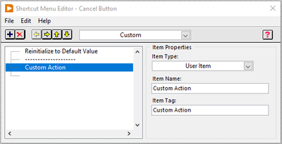

I have created the following menu which appears when right clicking.
I would now like to find a way to change the text of "Custom Action" to "Custom Action German" via programming.
The idea is to change the content of the Item Name and Item Tag according to the language in which the programme is set up.The problem is that I can't find the proprety node / invoke node to be able to access and modify the Run-Time menu via programming.
Does anyone know how to change the text displayed in the Run-Time Menu?

Hi Christian,
You can access the RuntimeMenu (and all its items) using the RuntimeMenu functions found in the UI functions palette!
Hint: you get the menu reference in the "menu selection (user)" event case…
