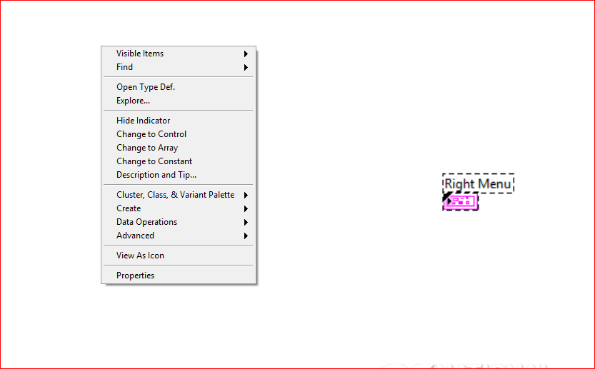

I am using a 4k monitor (3840x2160, 150% scaling) on windows 10 and when right clicking on the LabVIEW (2015) block diagram, any menu will display multiple inches away from my mouse or where I clicked. I believe this is due to a recent update although this started months ago (I've been using my 1080p laptop lately).
For example, if I right click on the "Right Menu" cluster, the menu will display as follows.
Right click display errorRight click display error
Does anyone know a work around for this?

This seems to be more of an issue with having two monitors with two different scaling settings. When I have all my LabVIEW windows on my 4k monitor, everything on the block diagram is scaled fine. If I have part of the window on the other monitor (1080p) then there is no scaling on the 4k monitor and the right click is off.

I've also had this issue, I have a 4 screen setup and it causes a nightmare. I have found a work around. The issue goes away if I right click on the block diagram and pin the pallette, further right clicks and any menu interactions work as normal. As soon as I unpin the pallette, the issue returns!
I have no idea why this works.
