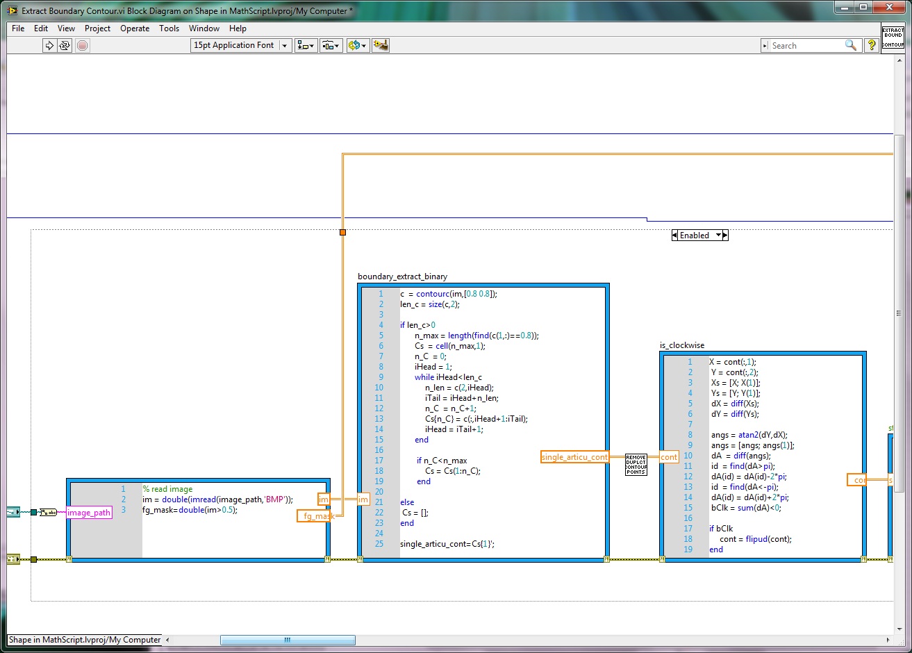

Hi, Tom,
I have this question about the perfomance of MathScript Node. In the 'Guidelines for Using LabVIEW MathScript', it suggests placing MathScript Nodes in a time-critical VI to boost the performance.
Well, I have many MathScipt Nodes in a VI. (I cannot find the page, but I think I read somewhere that says it is better programming to keep each MathScript Node short. That's one of the reasons I have many nodes in a VI).
My question is whether it is better to put each MathScript Node into a SubVI and make this SubVI time-critical, instead of putting all Nodes into one single VI. Or maybe it does not make much difference either way?. Thanks.
Message 16 of 17
(1,934 Views)
Hello MengHuiHanTang,
Either approach should work; there is a very small amount of additional overhead when calling into a subVI, but relative to the time it would take to execute your code this should be negligible.
The real advantage to putting your nodes into individual SubVIs is that you can easily create reusable libraries out of the functions you create, and it will make it much, much easier to quickly look at and interpret your block diagram.  I believe it will also improve your load and compile speeds, since the SubVIs won't need to be recompiled when the top-level block diagram is changed.
In summary- yes, I think it would definitely be worth it to put each function you've designed into a subVI and I don't think there would be much of a runtime performance difference.
