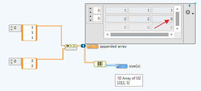

Here is a super simple example. The zero at the red arrow should not be there:
IF I am iterating the arrays in the bottom example how do I tell if that last zero is a real value or padding when the array was created?

Array are ALWAYS rectangular.  You can't have a 3 element row followed by a 2 element row.
What you could do is initialize a large enough array with NaN as the element.  Then use replace array subset to replace row 1,  followed by row 2.
The  "missing" element in your 2nd 1-D array should cause that element in the master 2-D array to remain NaN, which would be obviously not 0.

Arrays cannot have rows of different length; therefore, the Build Array function fills in for these cases.
I recommend you review the help document for this function: https://www.ni.com/docs/en-US/bundle/labview-nxg-nodes-api-ref/page/build-array.html, especially the Details and Examples tabs.

 Yes, LabVIEW cannot have jagged arrays. You cannot know if an array is padded with Build Array. You can put each subarray into a cluster (LabVIEW's "struct") and put THAT into an array, which will get you jagged arrays.
There is no NULL value but there is, as mentioned above, a NaN value. LabVIEW's doubles are IEEE-754 floating points, which doesn't have a NULL value.
