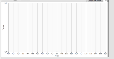

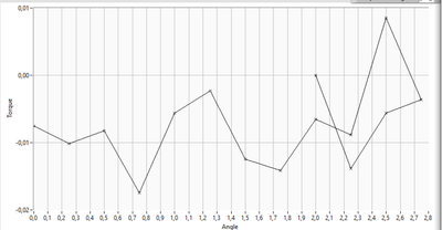

So my Problem is that if I reset the Build XY Graph on button click the actual graph does not rest completly.
I set the Reinitialize Value to 0,0 and if i click on the graph and say do it it actually does it. Also all values reset and the graph is clear but the problem is it is not resetting to 0,0. The last Value measured is still there and when i take new measurements it also start at this point. I attached some pictures Below.
So this is my little setup
This is it running and measurering.
And after pressing the reset button it doesnt goes to 0,0 like it should.
It stays at 49,0 no clue why.
When i then say manually by clicking on the graph -> Data Operation -> Reinit. to default it resets properly
Any idea how to fix this?

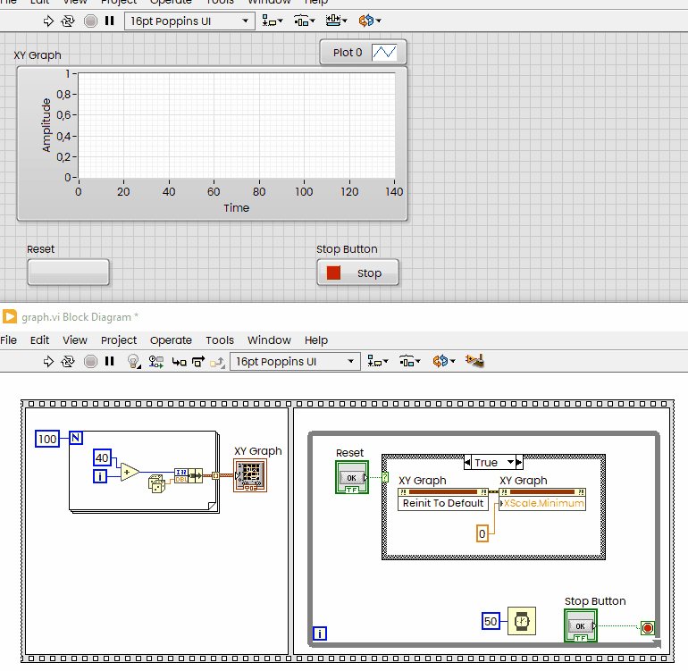

My graph don't gets resetted when reinit to default (in general this will reset the data only, but not scales)
Why do not use Scale.Minimum Property node and set it to zero on reset?

I could do it, but the problem is that the value is still there which shouldnt

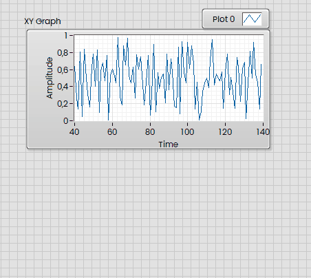

Hmm, for me it works:
Your "build xy graph express VI" is probably set to "retain data between calls", thus the data is stored in there. Don't use this express VI. We cannot tell from the picture!
You also have a glaring race condition that the reset happens in parallel to writing to the terminal, so whatever happens last wins.
