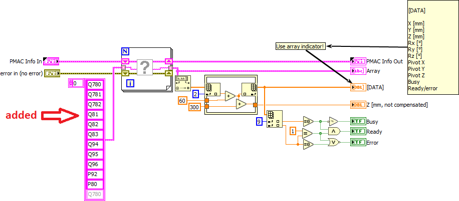

recently I took over an old labview project concerning the control of a hexapod.
The device accepts simple ASCII strings as commands for example for reading out the positions of the axes.
Because the previous VI was written by multiple persons and is rather old (read/write to xls doesn't work) anymore I have to maintain it.
Also I encountered some programming structures, which should be avoided like, in this case, (stacked) sequence structures.
I tried to change the sss to a for loop + arrays, as suggested in the forums, but I don't know if I did it the right way.
I attached a VI containing the former structure and my reprogramming attempt.
The attached (Sub)VI is meant to read the positions of the hexapod.
Could you please help me?!

Looks pretty good, but I think there are a few small bugs.
  • Your string array is missing Q81. Once you add that, the Booleans depend on elements at indices 9 and 10. You only need one "index array" for the output string.
  • It is probably sufficient to operate on the numeric array, no need for all these strings. (except for debugging)
  • I would recommend to eliminate all these scalar indicators and use array indicators instead.
Here's how it could look like:

@th.st. wrote:
I also did never work with in place element structures before; could you please explain how it is used and why? The Labview help explain that it will increase memory efficiency.
We don't really care about efficiency in this case. Here the IPE structure is just a clean way to modify one element of an existing array.
You can do exactly the same by indexing out the element, modify it, then place it back into the original array using "replace array element". More primitives, more wires, more places for bugs to hide. No reason for that!
