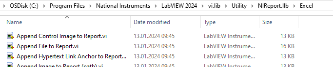

Its because of "improvement" NI has made with some common files.
Technically this class NI_Excel.lvclass is expected to be in "C:\Program Files\National Instruments\LabVIEW 2024\vi.lib\Utility\NIReport.llb\Excel", but was moved to "C:\Program Files\NI\LVAddons\rgt\1\vi.lib\Utility\NIReport.llb\Excel". As result LabVIEW searches this over whole vi.lib again and again.
All what you need is just to create Excel directory junction in "C:\Program Files\National Instruments\LabVIEW 2024\vi.lib\Utility\NIReport.llb\"
Just navigate to the folder where the Excel folder to be expected:
cd "C:\Program Files\National Instruments\LabVIEW 2024\vi.lib\Utility\NIReport.llb"
and then make a link:
mklink /j "C:\Program Files\National Instruments\LabVIEW 2024\vi.lib\Utility\NIReport.llb\Excel" "C:\Program Files\NI\LVAddons\rgt\1\vi.lib\Utility\NIReport.llb\Excel"
After that you should have link like shown:
with following content:
and the message will not appear, because LabVIEW will found this immediately.
