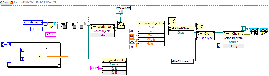

Here is a way to do it without using OLE Objects.  I confirmed that this method does not flash up the excel window when inserting the graph and it uses the build in charts (much nicer looking charts).  I quickly generated data and hardcoded the range of the data but you could easily create this range programmatically using your data.
aputman
Message 12 of 24
(3,354 Views)

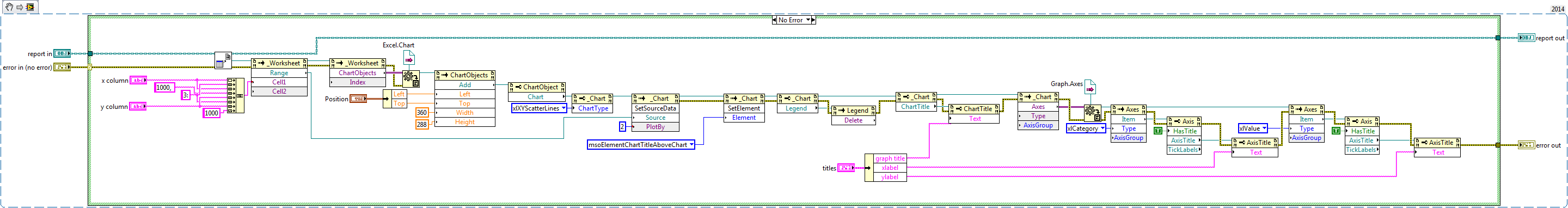

Thank you very much Aputman. It took me a while to figure out how to add titles and plot non-adjacent columns, but now I am really happy with the result. I went ahead and marked yours as the solution. Here is my revised "Make Graph" VI if anyone is interested:

Hi aputman,
I looked at your example below. I was able to create Excel._Chart (thanks for the help). From here, I cannot duplicate what you have below (I see the "Variant to Data" data output is connected to ChartObjects below which you have Add method, which is connected to ChartObject which is the Chart method)
I right-clicked on the "data" output of the Variant to Data -> create -> methods -> ChartObjects which puts a "_Charts" node on the block diagram with CharObjects and Index below that. (see attached pic). I just cannot find the Add method like you have in your post.
Message 15 of 24
(2,940 Views)
All the images posted are Snippets and are executable code, no need to re-write what you see.
Message 16 of 24
(2,904 Views)

Those images are snippets.  They have the code embedded in the image file.  Save the image to your desktop and then drag it onto a block diagram and the code magically appears (assuming you have the RGT installed).  No need to re-code it.
You may notice the "LV: 12.0" in the upper left corner of the image.  This is the version of Labview used to create the snippet.  If your version is the same or newer, the snippet will work for you.  If not, a LV11.0 version of this code was posted in this thread.

The fact that you had to google how to make a screen shot means you didn't read the link I provided.  Go to your block diagram, press CTRL+A, go to Tools >> Create VI Snippet from selection.  This image is now executable code.  Taking a screenshot of your whole computer and showing potentially private information probably isn't what you want (like knowing you use lotus notes).
It looks like you were able to open the snippet, and it looks like you have the Add method, for the Chart Object, what seems to be the problem?
