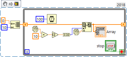

I have a set of random number values streaming in with a corresponding index value. The VI finds the index and places this value into an array using replace array subset. However, each time a new value comes in, the array only contains that value and does not have the old values. I want the array to save the last values from each index and only replace them when a new one comes in. The final output should be a 1x10 array with values contsantly changing

You can delete the for loop and put the shift registers on the while loop.

The VI posted makes little sense. You will never get a 0 index because you are rounding up. An index of 1 will never be replaced. See below for an improvement.

(3,115 Views)
That should be round down, not round to nearest.
(3,095 Views)
Thanks for catching that
