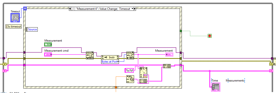

Ok.. I can't test my VI now, but i just implementet the "scan from string" box in my VI

You completely missed what I was trying to explain...
Let's see if I can rewrite what you did and show you an example of what I tried to explain...

Here is a snippet of what I meant:

I have tried your solution, and thanks for the help, but the array doesnt show any decimal number in the measurement part ?. I want two decimal numbers, how to do that ?

I'm not sure what you mean because it should work with decimals. See image below:
And it works even if there are no spaces:
+35.24g
will give
35.24

Hi Oesen,
did you read the context help as recommended?
Did you try the format string "%s%.;%f" after reading the context help carefully?

Hi Gerd,
Did I miss something?  Why "%s%.;%f"?
Does the OP want to conserve the + sign and save it into the spreadsheet?
If so, then using the indicator to export to the spreadsheet file may not do what the OP wants.

Hi Ray,
the OP said (s)he was missing "decimal numbers" (fractional part of the number). So I guess the computer the VI is running on is using a different decimal separator and thus included "%.;" in the format string to assure proper conversion of the value in the device string...

Thanks for the help guys. I wrote '%.;%f' in the format string box, and everything works fine now 🙂
