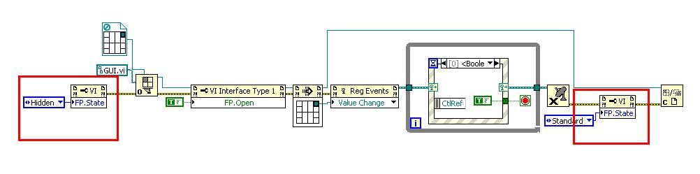

I have made slight modifications to your VI. I think this should work.

Brilliant! Thanks a million Smiley Very Happy

I'm not sure why this is happening. The image was appearing fine when I check it last!!
anyways..please find attached the image again...and the vi..just in case.
