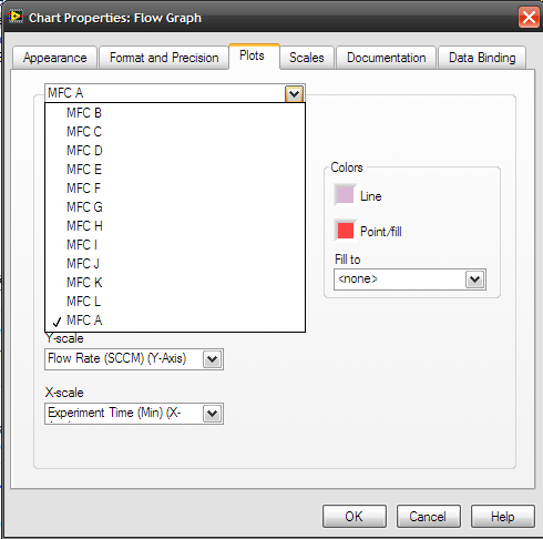

I think I'm missing something very basic here.  I have a chart that I can clear by wiring an empty array to the History property.  This works fine.  But, if I look at the properties for the chart, there are still 12 plots configured in the Plots tab.  How do I delete these?

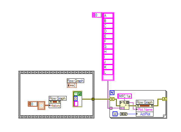

I wouldn't normally care about this, but I have a strange problem where I'm creating plots names via the active plot and plot name properties.  When they get displayed in the legend, they're out of order.  Note that MFC A is listed at the bottom, instead of the top.  I was trying to clear out the plots so it would reset itself, but every time I try to update it, it always has the order incorrect.  Here's a snippet of what I'm doing:
Any ideas?

Yes. Reverse the vertical order of the properties. Property nodes execute from the top down. So, you're setting the plot name before you've selected the plot.

You da man!
