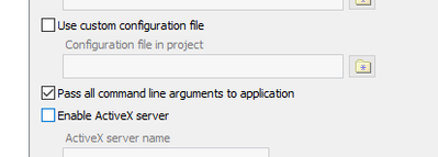

The way I normally detected what document opened the application was by using the "Application" --> "Command Line Arguments" property:
But this relies on ticking the "Pass all command line arguments to application" checkbox when building the application.
I've just been playing around with this and it appears that when this box is ticked, the "OS Open Document" event no longer works.
Anyway, using the "OS Open Document" event seems a better way of doing it, as the application can detect when the user double-clicks on an associated file even when the application is already running.
I've attached the modified sample project (LV 2017 version).
