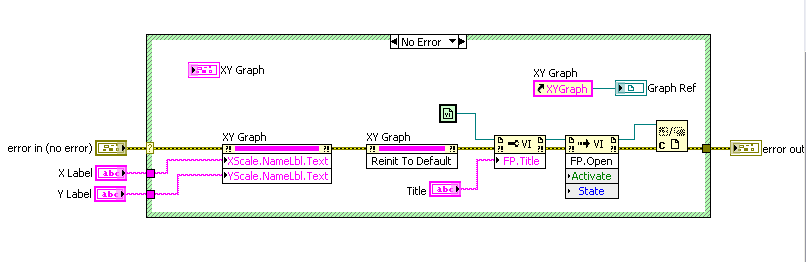

I am attempting to get a refnum to the Owning VI from an XYGraph refnum.  The catch is that I am running as a standalone exe (in debug mode) and the refnum that is passed into the property node to obtain the Owning VI is shown as "Refnum Not Available For RT."  The Owning VI refnum returned is invalid and when I pass it to the FP.Close I get an error.  What can I do to overcome this?

Kyle- you asked to see what was before.  Here goes:
I have a "Initialize Graph" VI that I call - that's where I first obtain the reference to the XYGraph.
 Then I call a VI to write XY data to the graph.  This one works when I'm running as an exe, despite the graph ref showing "Refnum Not Available for RT" when I place a probe on the ref.

I am just running a Windows exe in debug mode.  (Where you connect to the exe remotely from the LabVIEW project window in order to control the exe.)  I have an update about the behavior and was hoping maybe someone could confirm my findings.  Apparently I get the 1026 error when I'm controlling the exe remotely but not when I run the exe directly.  So the exe behaves correctly when it's not being debugged/controlled remotely.
