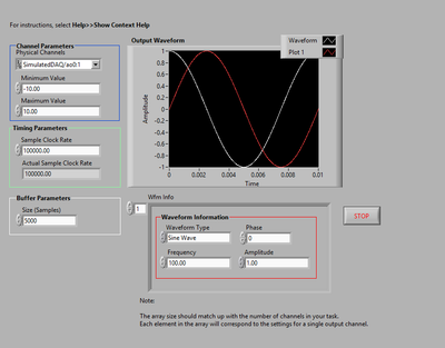

Thank you so much for your detailed help! I followed your instructions, and was able to successfully run my VI. However, I still can only change the waveform characteristics of one waveform (there are no toggles on the front panel to change the signal properties of the 2nd waveform, as far as I can tell). Is there a way for me to add a waveform property array that allows me to change characteristics of waveforms, going from channel 0->n?Front Panel Screenshot 1.png
I have attached screenshots of what I have so far, and please let me know if you think I'm making an obvious mistake somewhere.
Thanks again for your instructions,
Zach

Zach,
     Please do not attach "screen shots" of pieces of (or entire) Block Diagrams.  They are hard to see, impossible to edit, and impossible to test unless we do the laborious work of trying to duplicate your code, warts and all.  Instead, attach your VI, or, even better, if you are using LabVIEW Project to encapsulate all your VIs and they are all in the same folder, compress the folder (right-click folder, choose Send To and use Compress from the drop-down), and attach the resulting .ZIP file.  It's a single file, has all the TypeDefs and sub-VIs we might need, and, if necessary, we can actually try to run your code.
