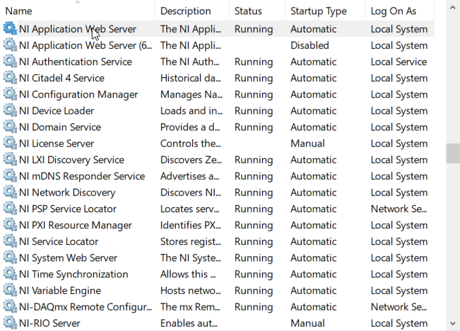

Sorry, more bad news -- I think I know what this is, and can suggest a "fix", but have one more test for you to run.  I really hope you are running Windows 10 (sorry that I forgot to ask that key question) -- if you are, open the Start menu and in the search bar, type "Services".  If you are running Windows 10, it should show you a Desktop App called "Services".  Run it.  You'll get a list of internal Windows routines called "Services", behind-the-scenes routines that "do things" for you.  Scroll down and find the ones whose names start with "NI".  Try to get a screen shot of the list, and post it.  If you can't post it, then count them and tell me how many you have running.  Here's the list from my Laptop (which is not running with a RIO):
I have encountered systems that worked, then stopped working, with a key symptom being the "disappearance" of a significant number of the the NI Services.  My Laptop has 19 NI Services showing, and when it went into "failure mode", the number dropped to around 12.
Before I tell you the Fix (which, if it is the problem I think it is, will be a little "painful", but should work), I want to be sure I've got the right problem.  So please try to post a list (or at least a count) of your NI Services.

Hi there, thanks for your effort in helping me !
There is 17 NI Services showing in total.

The Good News is that you do not seem to be missing important (and necessary!) NI Services.  When I saw that you had a few LabVIEW 2017 components installed on your LabVIEW 2016 system, I feared that the 2017 components would do to you what they did to me, and kill vital NI Services, requiring a complete removal of NI Software and a re-installation.
The Bad News is that (a) my myRIO is packed somewhere, so I can't test anything right away, and (b) I am not sure why you are having problems (sorry).  If I can think of something to try (and you haven't posted that you've gotten this fixed), I'll let you know.
