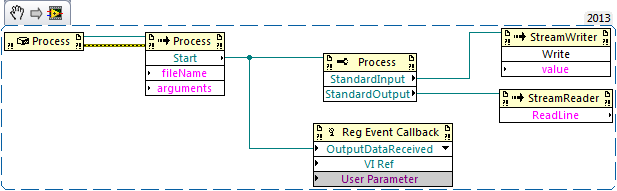

I don't think this is possible to do with System Exec but I think it might be possible using .NET (google turns up Process and System.IO.StreamReader) or using Pipes (??)
Edit - this should point you in the right direction:
(these might not be the right functions to use...I only glanced at the documentation - you can either read the data from the stream by polling or you can register for an event each time a line of data is received from the process)

I too had trouble finding it - it's under 'System' and then 'System.Diagnostics'.
The picture I posted above is actually a VI snippet - you can drag it onto the block diagram in LV2013 or above and it will re-create the code for you.
Just look at the .NET help for 'Process', 'StreamWriter' and 'StreamReader' - it's pretty well documented online by MS.

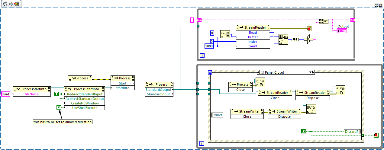

Ok, I got curious and decided to have a bit more of a play and I'm sure it'll come in handy at some point. Using this code/snippet I'm able to open up a command prompt and send commands (using the StreamWriter write function) and view the response in the 'Output' indicator.
On closing the panel, it closes the process (rather than killing it!) and then releases the streams which causes the top loop to error out and exit.
The only thing it doesn't do is actually detect if the process is closed (e.g. if it shuts itself down) but I think this is possible by checking a property on the process ('hasexited') or using an event callback.

If you're not getting anything on the read, does the SLUG program actually output to STDOUT? The example I showed redirects both STDIN and STDOUT to the streams...but there is also a stream for STDERR as well. I tried a few different methods of reading and the one I used in my example seemed to work the best. There was a specific reason why I close the streams from the 'exit' case - that stops it from hanging on the read when you exit as the reference is destroyed which causes the read to error out. You probably need to have a dedicated loop for reading, which is why I implemented like I did. Reading a single character at a time was very slow for me - doing a directory listing took ages to catch up.
You can turn off the 'create no window' - that should show the SLUG window while it's running...of course...if you're redirecting the input/output to the stream then you won't actually see anything there - just an empty command prompt.
As for the callback...
Drop down a 'register for callback events' node, wire in the 'Process' reference to the 'event' input, select the event from the dropdown box and then right click on the callback VI terminal and click 'create callback VI' - this will open up a VI template with the appropriate terminals for the callback VI. If you unbundle the pink cluster you will have an element 'e' which contains the string data. You can then use a queue or a user event to send that data back to your main loop (you can wire whatever you like into 'user parameters' and use variant to data to convert it back to whatever data type.
I had a look at your VI, it's essentially the same as what I gave you but you've scattered property nodes everywhere. You can also use 'writeln' which will automatically add the return to the command, instead of needing to concatenate it.
