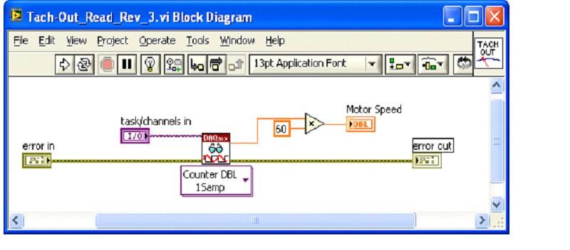

This is the code using the counter.  The Task uses a Counter channel for Frquency.   I set it for 1 sample on demand, Rising edge and 1 Counter measurement method.  It took a little trial and error for the multiplier to get the actual speed as it wasn't obvious what daqmx was using for internal timebase.  If needed, I can post a screen capture of that set-up as well.  This vi needs to run continuous.  I used a meter on the front panel with the additional numerical readout to give it a little jazz.
I have not been successful using a DIO yet and am still working that off and on.  I would like to be able to have five independent tach inputs for running multiple units on a life test. I will be trying some more next week and if/when I am succesful, I will certainly post.  If you have any ideas, I am open to try different things.
