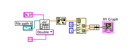

I'm trying to read a text file using the "Read from Spreadsheet" function. Next I want to plot the data in it on a single XY Graph.
The text file contains 4 coloums and the first coloumn is X axis and rest are for Y axis. I'm not able to get the multiple plots.
However, I could get it to plot when only a single graph is to be plotted(only 2 coloumn in file). I've attached my VI and a picture here.
I need help in plotting multiple XY graph from the text file with the 4 coloumns.
Message 1 of 14
(14,269 Views)
Accepted by topic author Bachna
Hi Bachna,
  You need to build an array of clusters to get multiple plots on an xy graph.You have created one cluster for one plot.Again you try to build an array similar clusters to get multiple plots.

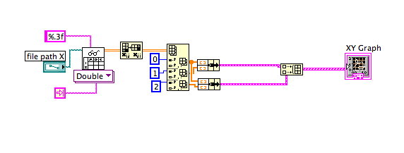

Thanks a lot SrikrishnaNF! You saved the day for me, it works perfectly now! Here's a picture of the VI.

Here's a more scalable solution, useful if you have one x and many y columns.
