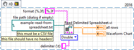

hi loewesh,
export your excel file as CSV (text file), there are other options, but that should be the easiest.
then read with "Read Delimited Spreadsheet.vi".
put your data either into a chart or a graph.
you can save the image below and drag+drop it onto a block diagram.
for ways to get data into charts/graphs have a look at the examples coming with labview,
search for "Waveform Chart Data Types and Update Modes.vi" or "XY Graph Data Types.vi".
hope that helps

With this diagram all the data is read at once, but I am trying to read the data second by second. This is, in the same diagram, two data: the data saved on the file and the data of the input which value is read every time the while loop is actualized.
Any idea?
Tank you very much.
Message 6 of 11
(5,175 Views)
Is the "input data" only a single sample for each loop iteration or many?
If only 1 sample, then go ahead and read the entire file as shown above and then use an Autoindexing Tunnel input on the loop.  Then you already have the sample you want ready to go to the chart.
If multiple samples, then you are probably going to want to store the index of the array in a shift register and then Array Subset to get the data you need to write to the chart.  Again, just read the entire file beforehand.
