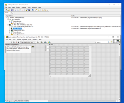

I am trying to read a spreadsheet using 'Read Delimited Spreadsheet.vi' on LabVIEW. The spreadsheet is saved in the tab delimited .txt format on my computer.
Currently I am trying to run a very basic vi that would read the .txt file and display the array that is read on the front panel. It could not be a simpler vi and involves just 1 line of code.
I want to use this vi as a part of a bigger program that requires me to communicate with a real-time CompactRio device.
The issue at hand is that the vi is not working (it is not populating the array) when used within the CompactRio target in my project (figure 1).
It does however work when it is added to the 'My Computer' target on the project (figure 2) 
One of my theories for this discrepancy was that the .txt file needed to be added to the cRIO target too for it to be found by the vi, so I did that, but it still is not being read (figure 3)
If anybody has any idea what I might be missing, your help would be so greatly appreciated. Like I said, this vi could not be less complicated, so I cannot think of many things going wrong, besides me missing a fundamental step at some point.
Thank you!

You need to use FTP or WebDAV to copy the file to your cRIO.  Just putting it in the project under the cRIO will not do the job.

if it is rather static data then you could add that file to your BuildSpec to get it deployed to your RIO RT target. It will end up in a "data" subfolder next to your RTEXE.
If the data changes often then you should learn from all those example projects coming with LabVIEW: they explain how to transfer data between host PC, RT target and FPGA (if needed/used)!

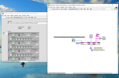

Thank you so much! That solved the issue.
Do you know if FTP file transfer works for other file formats like .blf as well? I have been trying to use read and write blf file vi's but even after using FTP I cannot read them on crio. I followed the exact same steps I did to use 'read delimited spreadsheets' vi  but while the latter worked, the former did not.
Here are snippets of the error I am getting. Figure 1 shows the 'blf being successfully read when added to My Computer and figure 2 shows the error I am getting when trying to run the same program under the crio. For crio, I tried using the path to the blf file on my local computer and on ftp. Neither worked.
Figure 1
Figure 2
I am attaching the vi with this post, along with a zip folder containing the blf read/write vi's being used.
FTP is a general File Transfer Protocol.  It will work for any file type.

Hi viamotors,
Those BLF functions all depend on the BinLog.dll included in your ZIP file.
When you check the properties of that DLL, especially the "Details" tab, it clearly says "Binary Logging for Windows".
(I guess Vector has no intention to provide their software for NI-made devices like cRIOs…)
When you look into the BLF functions you will find a lot of places with conditional disable structures hiding all those DLL calls for RT targets: that package is not intended to be run on a RT target!
